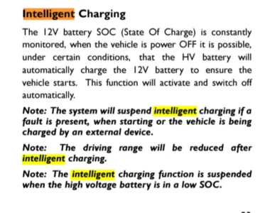

Where is the Intelligent Battery Charging option? Or is this something the MGS5 offers that the MG4 doesn't?
According to the MG4 Manual, keeping the 12V battery charged is 'intelligent'.

My conclusion would be that the "intelligent charging" isn't working. No matter the capacity of the battery, if it's getting charged when needed, there shouldn't be a problem.
Is this because the HV battery isn't full enough, or is there another fault?
That is another point I've already put to my local MG garage @decrep, in my case the 12v battery suddenly went flat, now I don't know if it was a gradual decline which was unnoticed or a complete failure of something, possibly due to the battery management system, but whatever the cause it appeared without warning.
Ah ... that totally uninformative section; the one where the "low SOC" isn't defined. 🤦‍♂️
I'm guessing it would be the same point it stops the V2L, 25% if I remember ...... I can't imagine it has a heap of different low SOC cut offs for each different function.
Either the MG smarts has determined the 12v battery is faulty because it can't seem to get it fully charged, or the "Intelligent" charging if faulty
