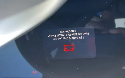

A couple of days ago I found that when I turned the ignition on, I received a message on the driver’s screen informing me that the 12V battery was low and some things might not work as expected. I needed to go out at the time so I couldn’t check the voltage, but everything seemed to work as it should anyway.

UPDATE.. I received the message again so i took my multi-meter and found that the voltage was 11.95 volts.....Hardly low, i was expecting 10 or below.
