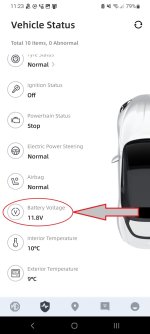

Anyone know what voltage the 12V battery needs to drop to before the Cyberstar charges it from the HV Traction battery? Over 2 days mine has now dropped to 11.8V, which seems low to me.

11.8V isn't just low, that's almost entirely flat. I wouldn't have expected the car to let it get anywhere near that low.
Just checked mine 12.1V showing on app, got in car Had Ready light come up app went to 14.1 volt.

My query was about what voltage level the battery should drop to before the Intelligent Charging starts. From what I can find out, 11.8V represents around 30% charge, so maybe that's an appropriate voltage. I wonder what other MGs do?
I thought I'd check back to the first EV I had, a Fiat 500e La Prima in 2022. I had a BM2 battery monitor fitted on that car, and looking back at the recordings I see that it also used to drop to 11.8V whenever I interrogated the car using it's APP. Presumably interrogating the car from the APP causes it to turn on various systems on the car.
So I'm starting to think that this is maybe normal on EVs.

It's dependent on temperature, but 11.8V is more like 20%. Hopefully the reporting of 11.8V or so is when powered up with some load, so it's really higher, as if a lead acid battery is constantly cycled that low it won't last very long, better to top them up at 40% or more.

I've now measure the 12V battery voltage without using the APP (with a multimeter), and it read 12.4V.
