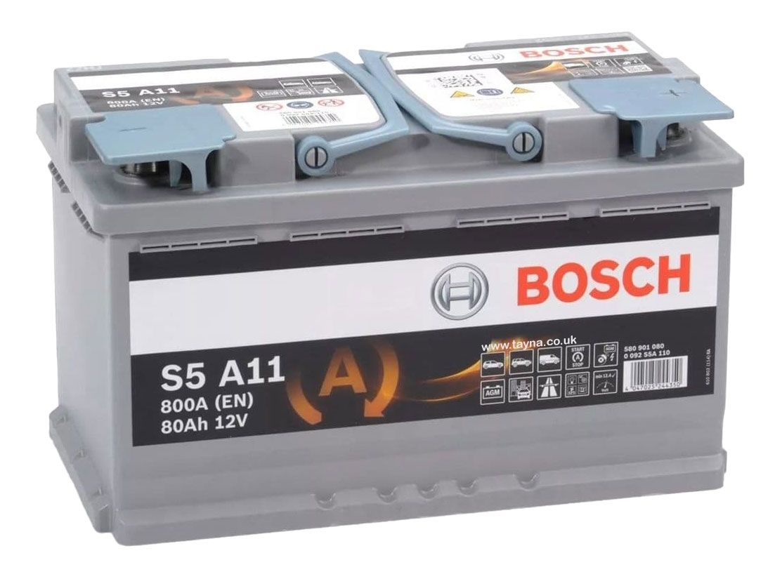

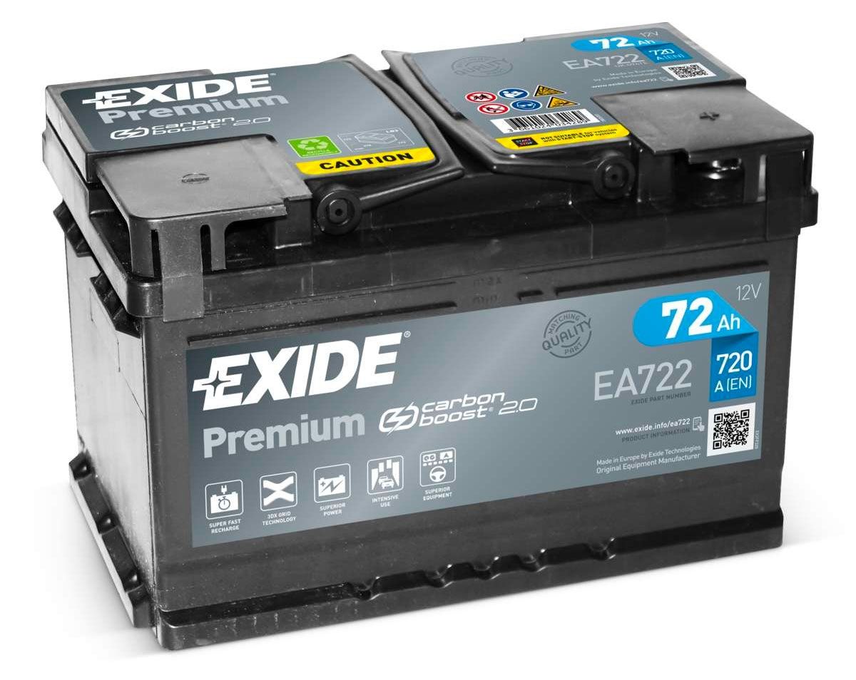

Pretty much any standard lead-acid battery that fits the dimensions and has equivalent standard amperage will do. (Cold Cranking Amps - CCA - are somewhat irrelevant for an EV).
Just curious how much a new battery would cost? Do it have to be original from MG, because I can't seem to find any alternative.
You could try getting a quote from Tanya.
They do next day delivery in the U.K. and they are used a lot by people in the trade.
Go to the web site and use your registration number to search for a battery.
If it does not find a match, just contact them and they will find you a suitable battery.
Here is just a very rough ball park figure ( price ) for reference only.
The Bosch units have a five year warranty that is a handy feature.
You will need to cross match for suitability and sizes etc.
