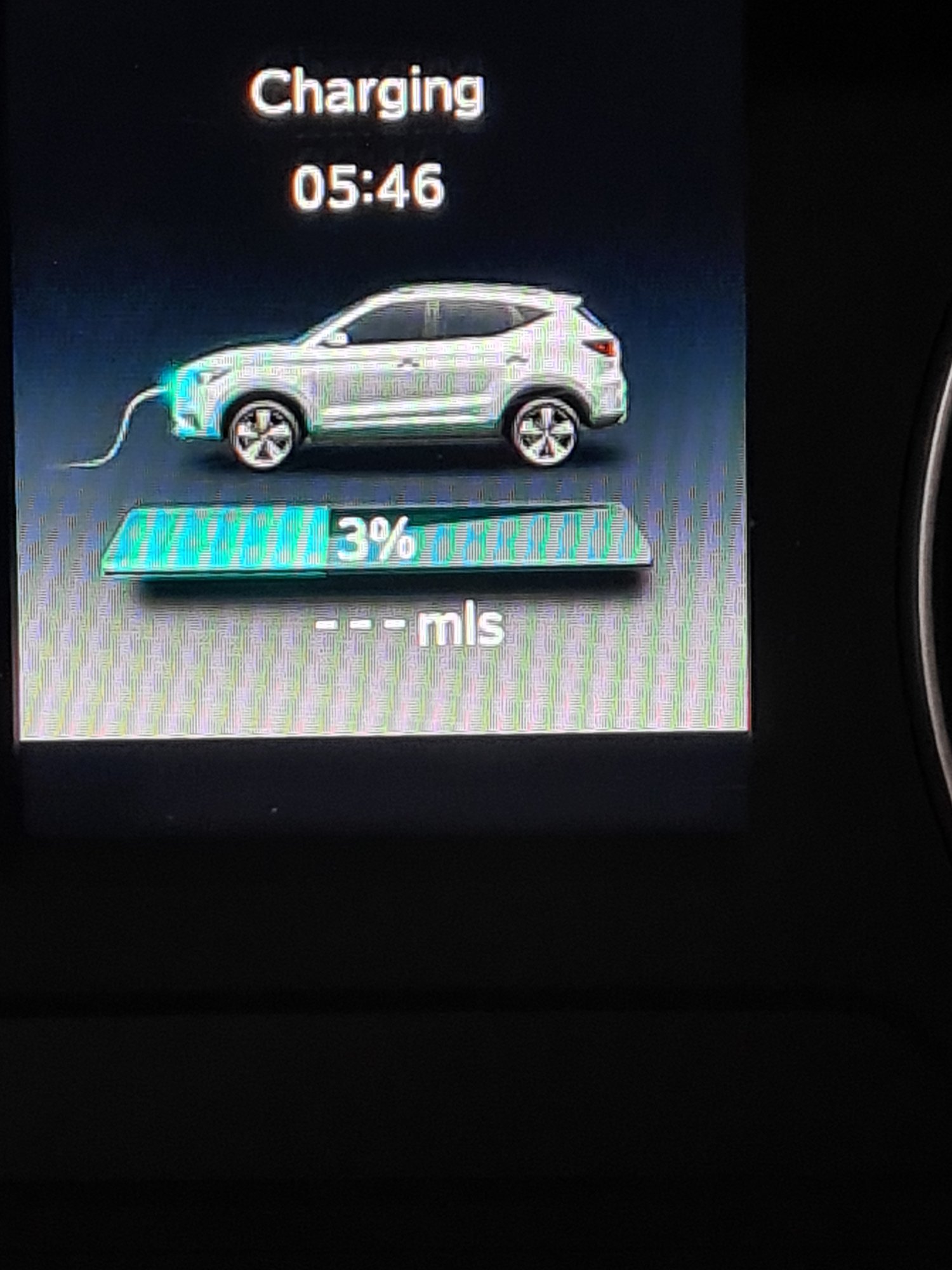

My MG ZS EV after one year, working as uber in London. Recharge every night.
The battery loose 8 miles from the original 163.
But I can manage to do 173 miles in ECO mode, 90% the day with air conditioning on, driving in the city. View attachment 4340View attachment 4341
@Taliano2
This is VERY interesting, you have the highest mileage done of anyone that I've seen.
If you wouldn't mind, a few questions that would provide invaluable to the rest of us owners.
Following a full AC charge (and balance?), what GOM do you get in Normal(3) with both trips reset (start car without brake pedal pressed to ensure no HV battery load going on)?
What voltage do you have showing too at this point?
Do you have access to the OBD2 data via a dongle/app, if so the SOH% would be great to know.
Roughly what percent of your charging is via DC rapid chargers and how much via AC charging?
Thanks so much.
