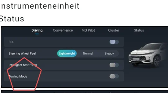

In my 22 phev info screen there are options for the sensors, I found it annoying when it kept popping up and beeping when in traffic or stopping at traffic lights with a car in front.

You can also slide down the main screen, which brings up another menu, and just select “Parking Radar” and that also turns it on.
