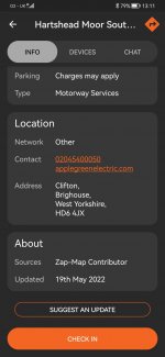

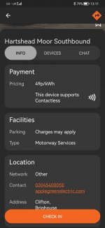

Yes, it was hartshead Moor but the also have applegreen 350kw chargers next to the tesla rank.
Looks as if Applegreen is a network not covered by Zapmap. It's not one I've heard of. How much do they charge per kwh and do you need an app or are they contactless?
They are on zap map, in fact, they're a zap map contributor.
It was a contactless one as I think they all are but don't rely on my guess at that.
