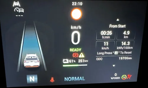

I've had my used MG4 Trophy Long Range 2023 for a month now and, aside from a few niggles with the infotainment system and the issue I'm about to discuss, I'm very happy with it.
This airbag warning issue has happened twice since buying it. In the car the yellow warning light comes on and the red airbag symbol appears along with a warning message.
On my phone and app I get alerts flipping between
"Airbag warning: The airbag of your vehicle has triggered an alarm" and
"Security alarm cancelled: The security alarm is released. You can now drive your vehicle"
This goes on for about ten minutes, then everything clears and it's all fine again.

I had this fault, very intermittent, some days it would ping on and off over and over and over. Other days it wouldn’t happen at all. Took me over a year to get it sorted properly with various connectors being replaced over several visits, turned out it was a duff seat airbag, once they actually took time to look into the fault properly instead of rushing to tinker with the connectors and ring me to collect it and replace the airbag it’s been fine.
