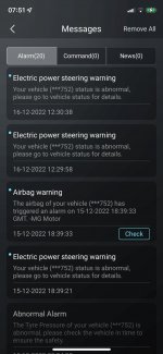

See attached MG App alerts - this is the latest selection in a list of 20 alerts

Airbag warning messages have been mentioned on here before with the ZS model: Airbag warning in MG iSMART app but no mention of the bag itself deploying to any extent.
