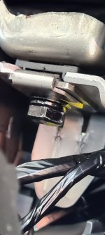

Just another update. I posted on this thread a few months ago a detailed step by step how to tighten the bolts under the steering column to stop the knocking. Well, the knocking came back a very small bit, so I decided to tighten the bolt under the scuttle panel under the wipers. I got two full turns on the bolt and the knocking is completely gone. This was a pretty easy process.
1, disconnect the wipers
2, take off the screws holding the scuttle panel to the car.
3, slowly work the panel off and sit it on the engine compartment. That way you wont have to disconnected the pipe for the windscreen washer jets.
4, tighten the bolt as seen in the picture, a 13mm socket will do the job. Dont over do it. Be careful.
5, stick a bit of grease on the wiper rotator thread before you put the wiper back on.
6, put everything back the same way you took it off.

So I have an update on the increased play in my steering. If you look back on my previous posts in this thread, you will see a detailed description on how to tighten the bolts on the steering column and under the scuttle panel.
Around 6 months ago I had alot of play in my steering wheel along with an annoying creaking noise or knock. I fixed it then by tightening the two bolts as previously discussed. The noise was gone completely and all was good. Until last week the noise came back but not as bad. So I removed the wipers and scuttle panel as posted a few days ago. The noise seemed to have been gone, but it was still there intermittently. So today I went at the bolts under the dash/on the steering column. I have a much improved method of accessing these now, rather than the longer process where more panels had to be removed. This new process only requires three philips head screws to be removed. One at the bottom of the steering wheel cover and the other two directly behind the steering wheel, the car will need to be on for these two as the steering wheel needs to be turned 90 degrees to see the screws.
Then the top part of the cover pops off and can be stuck up out of the way. The bottom will drop down just enough to get a 13mm socket in, if you release the steering wheel adjustment lever.
I managed to get a half turn more on each of the green marked bolts. I have driven the car for 5 hrs and no noise. I wonder if the noise came back as we are now in to warmer weather and that somehow caused it to loosen?

Interesting. What size are the bolts? They shouldn’t work loose.
Ok. So not a small bolt. Any locking or spring washers?

I can’t see that coming undone on it’s own once it’s tightened properly. Looks very secure ?
I suspect the annoying click/knocking noise comes from metal on metal moving against one another really slightly. And by tightening the hell out of it prevents this rubbing.
I think if it comes back I will remove the bolts and put a washer of some sort between the metals, maybe a rubber or fiber washer?
