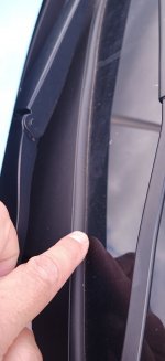

I got some teflon tape today and am going to apply it tomorrow and report back. There is a creaking noise coming from the front of the dash since I removed the scuttle panel to tighten the bolt for the other noise?
Spray teflon on it and it is gone
For the creaking noise, spray wd40 or Silicon spray or teflon at not to much,
WD40 will only cure it for a very short time, it is a penetrating spray.
Silicon is a better option really, get the nozzle behind the plastic / hard rubber gasket a go right across the scuttle panel.
Sprays aren't a good long term option. Apply a thin foam or felt material backed tape to the original seal having taken off the scuttle panel and cleaned it, then refit, for a permanent solution to the issue.
Bang on !.
I used WD-40 DRY PTFE spray from Screwfix it's for glass , plastic , metal etc .It's a brilliant lubricant , only had to use it once 6 month's ago only a 5 minute job. Use a plastic trim tool behind the windscreen trim rubber to hold it away from the screen enough to get the spray extension tube in and pull it along the trim spraying at the same time job done , because it is dry PTFE it creates very little mess ??

I gave my scuttle plate a good spray with Silicone WD-40 about 6 months ago and the creaking has not returned since. I did not even bother lifting the rubber seal as I thought that being liquid gravity would help it get under it. ?‍♂️
