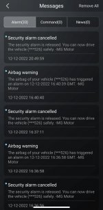

Yes on all the time and tyre pressure light too plus location as well drrr but at least it charges fast
Just checked my app - no alarms showing at all, even though I've had warnings re. High Beam, LKA, ACC, AEB etc. (due to the windscreen camera being blocked). Not sure if they would show in the app though.
