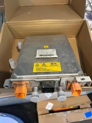

Well the EV garage are 99% it’s the onboard charger that’s gone and unfortunately they can’t fix it as it’s a MG dealer part only that needs coded to the car! They are running more checks and will confirm tomorrow! The part is over £2k alone *** 🤦🏻‍♂️

The CCU needs coding in and only MG can do this, my independent garage could have replaced the part but doesn’t have the tooling or software to code in?! 😩
It is possible for an independent garage to purchase a VCI and download the necessary service software from the MG service portal.

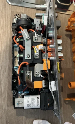

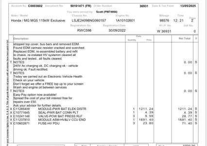

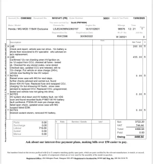

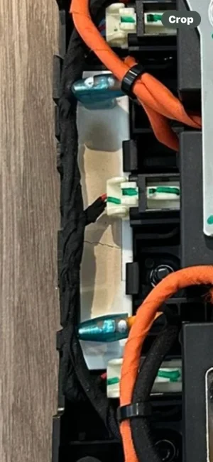

Well I got the car back yesterday, total bill £4466 😩 I had a meeting with the manager and master tech that did the work where they explained the repairs and gave me the parts away 🙈 Did 160 miles today and all is well, it’s on charge now and no issues 👍🏻 I’ve added the invoice showing the repairs (if you’re interested) and the parts damaged/replaced! 🤓 Just glad it’s over now, it’s been a stressful 4-5 weeks 👀

Not sure what ‘battery module’ they are talking about.
With the explanation on the final bill, it seems that it's the high voltage distribution module, which seems to be a glorified junction box plus it seems (at a stretch) the pre-charge resistor, and possibly the main contactors. But the pre-charge resistor and contactors are usually in the main battery module.
It's a sign of the times that the cracked and scorched ceramic resistor (worth perhaps £25) was replaced by swapping out the whole distribution module (costing £1700 presumably plus tax), and would have been a fair bit of labour to replace (all those stiff orange cables with their bolts). If only more repairers did board level repair. Actually, the pre-charge resistor is sometimes bolted in with flying leads, meaning no soldering required, just a smaller socket for the wench!
(y) almost unbelievable.
They even invoiced it as a Honda, doh.
