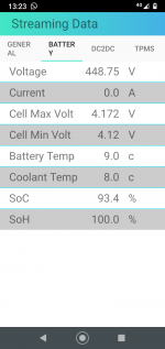

Here's mine, getting there.
Vltage 448.75
Max 4.172
Min 4.120
SoC 93.4
A 52mV (0.052) imbalance is not particularly balanced, does it try for the full 10 hours to balance?
It goes for quite a while and is improving.
Comparing previous and current readings from OBD2.
was and now figures
Vltage 448.25 --> 448.75
Max 4.171 --> 4.172
Min 4.107 --> 4.120
SoC 93.4 --> 93.4
was and now figures
Max 4.171 --> 4.172
Min 4.107 --> 4.120
SoC 93.4 --> 93.4
It's slowly getting there then.
Your figures show what I suspected, the SoC is based on the Max cell Volt and not on the total Voltage.
