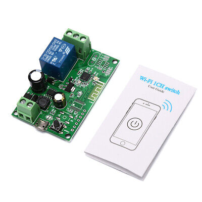

Thanks Paulie. The Sonoff wifi basic switch I can see is 240v AC, rather than 12vDC. Is there a DC version? Can you provide a link?
This is the one I used:
This pic shows an AC Sonoff basic switch, rather than the 12vDC version
Sorry for being thick but presumably to use the DC version the wiring is different?
Are there pros/cons on using AC or DC switch?
Yes, the wiring is quite different. You supply the relay unit from the 5v\12v in your charger thats on the low voltage control board, this will be available somewhere on the board just after the rectification bridge and smoothing capacitors, and will vary by manufacturer. You need basic electronics knowledge to recognise components and a voltmeter to find this. The signal wire from the socket is then cut and wired to the relay switch to allow it to be opened and closed by the WiFi. Timer app.
