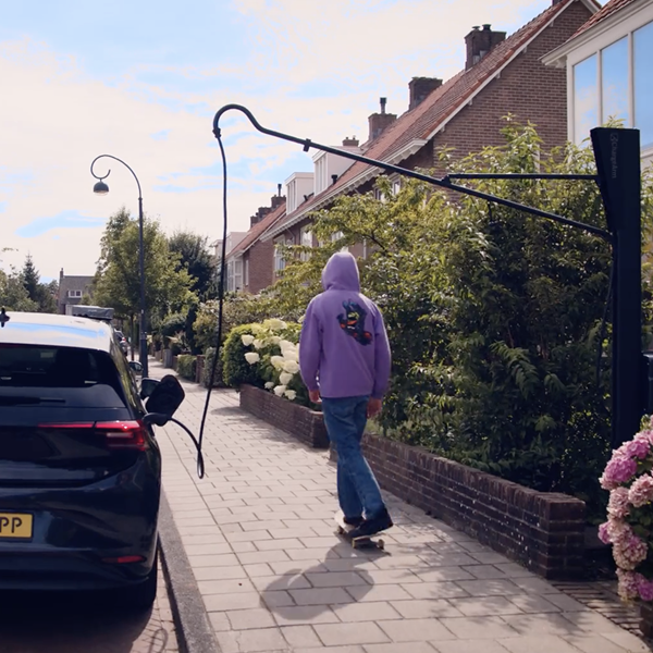

Something similar already exists in The Netherlands, although I wonder whether the Yoof in the picture would have been tempted to swing on it - I would have been at that age.

also, as per pic above, imagine trying to route a cable in that modular paving with out causing a hazard? 🤣

On the issue of going above the footpath there are numerous examples of signs and other street furniture going over footpaths. Greenery such as bushes and trees overhang in almost every council area, The requirement is that they should be cut back to the path boundary or the tree trunk up to a height of 2.5m before going over the path. If the arm could swing back to the wall when not in use it would be better.
On the matter of the channel I think I would want a "I" or "T" shaped insert to go in when not in use to reduce debris working its way in.

May have to argue the point but if the charging gantry is NOT an obstruction then it should be allowed. This is where central government instructing councils to support the use of EV might be of benefit.
Agreed. There is still a height restriction as previously mentioned. However, this will be very small beans to be compliant. Maybe a pain if one was unfortunate enough to have a footway/cycleway outside their house. Even that being said, 2.2 metres is still easily achievable
