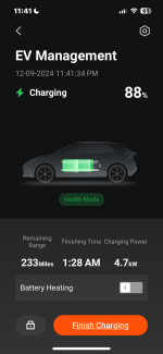

I rarely use the car setting at all, I always set it to health mode in the app. In fact it’s set to health mode (80%) right now in the app and is currently charging away at 88%
As a rule don't trust any of the values shown in the app. I have noticed it give wrong values for lock status, temperatures, charge percentage and scheduled charging times in the past.
Mine doesn't do that, in previous charges it has been set to health mode and when the charge reaches 80% stops charging as expected.
