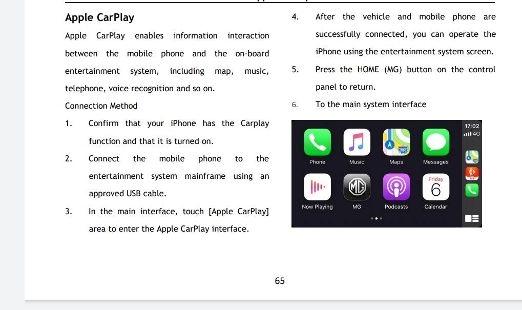

From the manual:
"Vehicle-Mobile Phone Interconnection
Note: Only the USB port on the driver's side can support vehicle-mobile phone interconnection."
Come on ........ no one reads the manual !!
