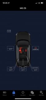

Hi I have an unusual issue I think. My ZS EV was in a garage for repair for over a week. During this time the 12V battery became critical - I have OVMS so was notified. When collecting it I recharged the HV battery overnight but this has not charged the 12V battery. OVMS has stopped polling as the voltage is too low. From other conversations on here it seems that the 12V battery is only charged by the HV battery when the car is in use, so the only way to charge it is to go on an unnecessary long journey.

Final update. All sorted. The battery is charged and working fine. OVMS is now playing up but that’s another stpry
Btw, I don't know what ovms is, but if it's something that runs via the odb2 port, is it possible this drained the battery?
OVMS is an app that runs on a smart phone, combined with a gadget that fits the ODB port. It polls occasionally draining some of the battery but stops when the voltage gets low
