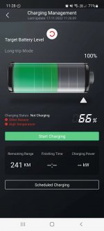

Has anybody had a warning on their app on charging managment of high temp in red.
Ive just plugged in its 8 degree outside raining. Screenshot_20221117_112851_MG iSMART.jpg
Was checking the charge on the app last night when these two red text warning came up. I toke it off charge then put it bk on this morning and they are still there charging or not. Anyone else having this come up.
No warning on the car itself

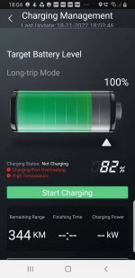

Charged overnight as per usual. When I checked my mg app to see if it was done I clicked on battery management section to see a red message saying Charger port overheating. See photo. Anyone else had this before?
Yes I've got it right now.
Yes, I unfortunately updated this morning. Same issue and also it's stuck in Kilometres!

Hi, I'm sure it's a bug in the app.
I have same problem with app and also car does not charging either. Charging port overheating message appears in app all the times. I tried to charge with slow and fast chargers but does not charge at all.
Personally, I have never witnessed this warning myself sorry.
Did this happen while attempting, or after receiving a charge or has the warning ⚠️ just suddenly appeared for no apparent reason ?.
If so, it could just be a rouge software glitch, not that uncommon.
Have you attempted to carry out a charge since receiving this warning ?.
I taken it you done another car health scan with the App.
When you put the car in READY mode, does it flag up any warnings on the dash panel at all ?.
If the car does have a fault, the car will flag up I am pretty sure !.
Thank you, I'm having the same on screen on android app
I'm having the same message on the iSmart app (on android). It started after the app updated on the phone. I checked several times while charging and the car accepted a full charge with no issues. I'm assuming the problem is with the updated app and not the car.
I reckon when they were testing the update, they forced the app to think there was an overheating issue to see how it would display the error and forgot to undo the force when they were finished. Before this, I didn't know this could be an issue... now I'm wondering if the port is overheating but I don't know because the alert is stuck on (although I imagine if there was a real issue the app would make noise too)
