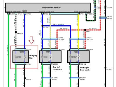

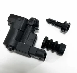

I'm currently having trouble with the charging port stem, as it's made of plastic and shows signs of wear.
After some research on AliExpress, I found a model that appears to be the same.
I tested it with the device disassembled and noticed it has a magnet that should activate a magnetic switch.
I'll confirm its compatibility once I receive it.
