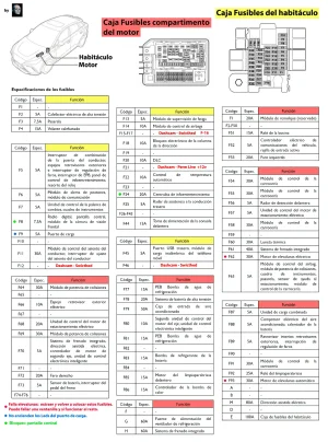

Try this - maybe it will fix it.
As @jamakr4 mentioned, and as you can see in the video where it's located, I've had the charging light fail. Most of the time, removing fuse F9 for a few minutes fixes it.
This 5A fuse is located in the vehicle's interior compartment.
I've attached a wiring diagram. Apologies, but I made it myself, and it's in Spanish.
The FuseBox design is easy to understand.
For better comprehension, there are also diagrams in English.

Remove F9 for a few minutes, I've left a comment about it.

I'm mentioning the fuse issue because of a possible system freeze and the possibility of resetting the module.
It's something we can do at home to rule it out.
Here in Spain, there have been quite a few cases, removing the fuse usually fixes it.
Of course, if there's a real problem, there's not much we can do.
