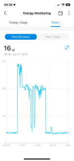

I used a Tapo P110 smart plug with my granny charger for a while which worked well - £10 on Amazon.
Yes,, me too ... very useful as all the info is available on the TAPO app including graphs and monthly totals. No hub or anything extra required either.... just the App.
Just make sure it's the P110 as you say which is described as "Tapo Smart Plug with Energy Monitoring" as there is a lesser model (the P100) which does'nt have the Energy monitoring.
I guess those smart ones have to be paired with a WiFi network, which would cause frustration if you're using it when charging at someone else's property.
I was just considering putting my non-smart one (similar to this - https://www.amazon.co.uk/Electricity-Besvic-Monitoring-Consumption-Protection/dp/B0B3MQ6V86/ ) in the car in case it comes in handy. Then I remembered that the one time I've considered granny-charging on someone else's property, it was an outdoor socket in the pouring rain...
I’ve ordered it. I’m just not sure how strong the WiFi is in my garage.
Of the device loses connection, does it store the energy consumption until the next time it reconnects?
I’m considering innr as an alternative or simply buy a WiFi extender
If you have a dual band router use the 2.4GHz band for it as it's more stable over longer distances and better at penetrating walls
