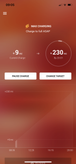

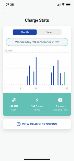

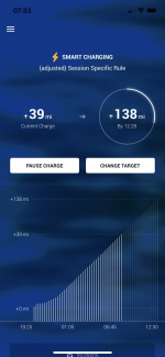

So this is how I get full speed charging using the smart charge function witch I have to use for 5p/kWh charging
I don't need the car till 2200 but its the wife's car and she will use it during the day my round trip to work is 60 miles at motorway speeds with a heavy foot so I set up ohme to give me a 200 mile charge by 1500 but really I only need 25/30% as you can see pic 1 the smart charge is a steady graph to 1500 but pic2 shows car will finish at 0444 even if I get home late at 0800 I plug the Ohme in and I get a message we are charging you at full speed but won't finish in time only cos it thinks I need 80% charge but I just ignore the message as at full power it's only a few hours to get my 30%
Hopefully this will make sense ?

Hi I have an Ohme with the same 5p Drive Anytime tariff as you with OVO.
If you have your cut off at 90% (photo 2) I’m unsure as to whether OVO count this as a scheduled charge as it was interrupted. (Imagine your scheduled charge needs to go to 95% but your cut off on the car app is lower - eg 90)
Do you know if this is so? I’ve often wondered.
I guess it’s the same as if you disconnect the charge before the end, yourself. ?
@muppet77
They have no idea as to how much charge is already in the car mg don't use api support so the smart charging has no idea if you stopped it or the car
