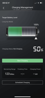

If you press the battery on the app it puts you into a new screen with an option to start/stop Charge

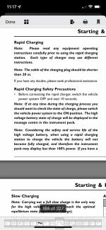

Manual states turn off for 10 seconds before rapid charge
