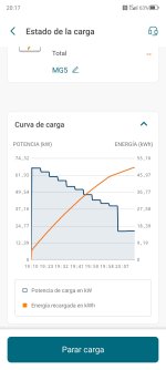

This is the charging curve I got from a 160 kWh charger the other day. Worth mentioning it was 0 °C. Cold makes the charge slower. Hadn't seen this stepped behaviour before, but probably it is because most of the chargers here in Spain do not give you a graph with the charging speed. It was a long trip, it was cold and I had to maximise autonomy.

That's about what I see on ultra rapid chargers, they don't seem to like the MG5 for some reason, especially in the cold.

Nothing to do with the rapid charger, it’s the MG5’s BMU that limits the charge rate due to low cell temperature.
Overall goal is HV battery longevity, not performance.
