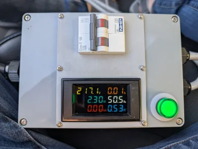

Hey Terry. Just finished upgrading my V2L adaptor to 7kW. For those looking to copy, I take no responsibility for your assembly skills etc. Here I included a 32A breaker as an isolator switch. All stranded cable is terminated with bootlace ferrules to address the risk of loose strands causing hot joints. In my case I've used the same resistor as Terry but on light duty 250V rated flexible wire and zip tied in place inside a charging plug. Wires are crimped to the pins. The energy meter is a CT type with the CT coil threaded over the active wire inside the grey box.
The 15A outlet plugs also have the wires crimped with bootlace ferrules to mitigate hot joints under heavy load. Not sure if I will leave the breaker at 32A or change it to 25A as I don't know if the inverter/charger can handle the full 7kw for continuous use.

Hi Ray, looks good, why the fancy readout box ...... because you could I guess :LOL:

Hi Terry. I had one of the energy meters leftover from another project so I thought I'd add it to the box.
