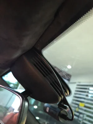

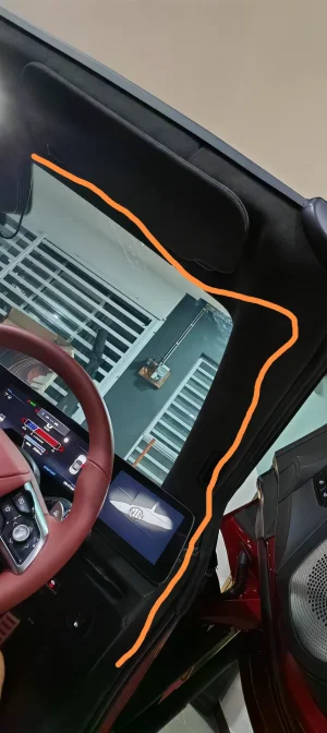

I installed my dashcam and used the power from the ceiling light module. This is really nearby and delivers 12V while the car is switched on. My dashcam runs on 12V. If the uses device runs on USB, a current adapter is needed.

I won't unplug it again, but here more explanation.
  • In the first photo, you'll see the lights module with two silver clamps facing to the mirror. Place a plastic tool there or just draw it gently down.
  • Second photo shows the plastic cover at the mirror. Just level it from the hole. Both are very easy and don't need much force.
  • Third photo I placed the cable from the front into one of the vent(?) holes and fiddled it to the now open area at the mirror. From there further to the hole, where the light module sits.
  • There, you insert the red and black cable of the dashcam cable into the black (-) and white-black striped cable (+) you see at the right hand of the picture. Fix it with hot glue or tape. That's it.
