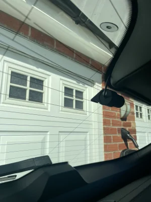

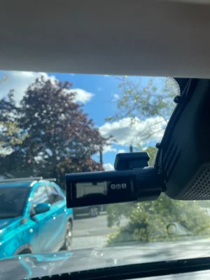

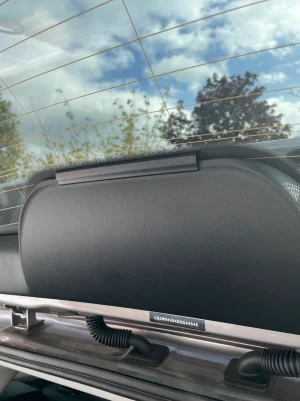

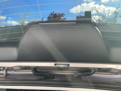

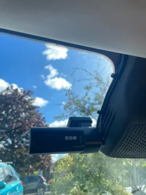

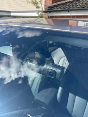

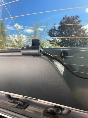

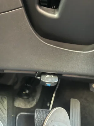

Had my dashcam fitted professionally this morning. The trim in question popped off in seconds. Very neat job, using the rubber conduits to route the wires. All cables really well hidden.

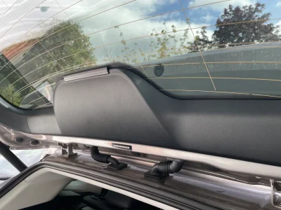

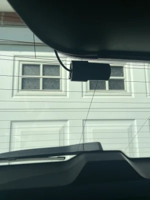

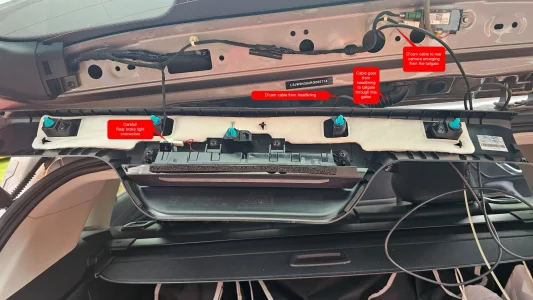

UPDATE Using the trim tool that came with the dashcam kit - I inserted it at the top of the right side and moved it down the join and gave it a hard tug and it released. Did the same on the left side. This makes it easy to get the trim tool into the gap at the bottom and give it a hard tug around every 6 inches (there are about 6 clips holding the panel in place - and they are really tight). Be careful - the cable for the high brake light is connected from the body of the car to this trim). This was a test run for me and I will take a pic when I next have it removed (when I fit the rear camera).
There are actually 5 clips holding this in place - all rather a tight fit and a bit scary! Attached is the picture of the panel removed clearly showing the blue retaining clips. The cable comes from the headlining into the rubber gaitor (there's only one other cable in this gaitor - I used a long cable tie to pull it through) and emerges from the tailgate. The panel goes back - with a firm push at the clip locations - I did left side - right side - then the 3 other clips. I'll get another picture of the camera in place - I attached mine to the brakelight cover rather than the window.
