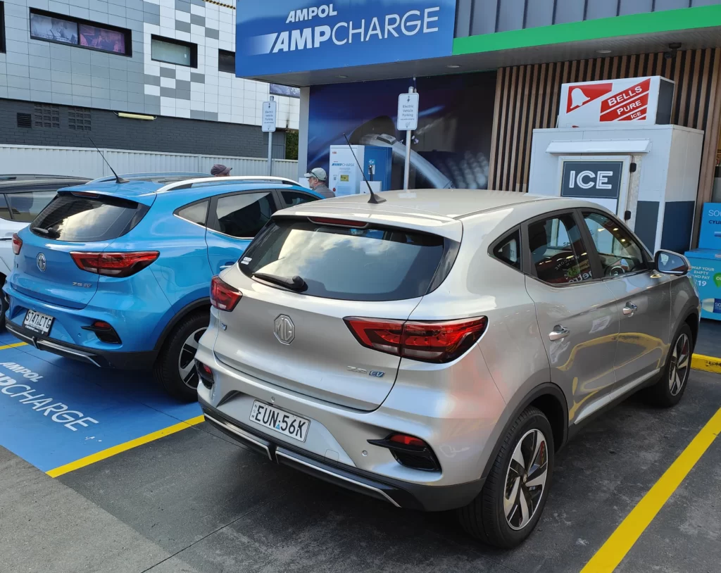

According to the company who the OP is referring to:
“All our DC chargers provide the full supported output range of up to 920Vdc. Some of our chargers do have low current cables (200A) in order to help improve overall usability and reliability for individual and concurrent usage at each charging point”.
“With the low current cables if your vehicle’s battery voltage is 800V then you should be able to get up to 150kW of power under the right conditions. If your vehicle’s battery voltage is 400V then this would likely be closer to 75kW”.
“However, charging times are not guaranteed and can depend on your vehicle’s battery size, your vehicle’s charging capacity, the charge state of your battery and weather conditions”. We remain focused on providing a strong customer experience as people transition to EVs”.
“All things considered, we feel higher current cables can have a detrimental effect on customer experience, reliability and safety given their weight. We are consistently monitoring customer feedback as well as technological advancements to ensure we get the balance right”.
