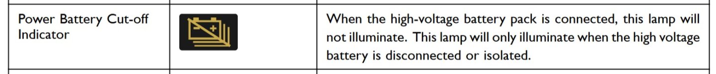

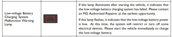

Anyway, it's strange that the car is showing both warning lamps. From my point of view "Power Battery Cut-off" would be enough. Why it's showing "Low-voltage Battery Charging System Malfunction Warning" lamp? It's obvious that low-voltage battery charging system doesn't work because main battery is cut-off, isn't it?
Such a key position would allow you to turn on your radio without any other systems active.
I know what it is, and what it is for ... I've merely never seen or heard it referred to as the ACC position until this thread. :)
