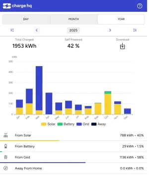

Another option is to use ChargeHQ.
It provides detailed reports on all home charging sessions. But you'd need their paid service to download the data. This is probably sufficient though.
screenshot-2026-04-25-at-9-06-14%E2%80%AFam-webp.46013
Your charge station would need to be compatible, anything with OCPP 1.6 or higher (open charge point protocol) likely will be.
The subscription for the service should also be claimable, not sure current price, it was $7/month when I last looked. But if just doing scheduled charging and being able to view the data is all you need, then it's free,
I used to use ChargeHQ for controlling my ZJBeny charge station but stopped the paid option a few months back as we now have the Sigenergy DC charging module so I rarely use the AC charge station any more. It's still controllable with ChargeHQ on their free service and I can do schedules or manual control but no charge from excess solar or downloadable reporting. The still provide the data on screen though in the app.
It can record away charging sessions for compatible vehicles (e.g. Tesla) but not for the MG4. You'd need to keep your own record of fast charge sessions, which isn't hard as most charge networks provide that as part of their app. I just put my DC fast charge sessions in a spreadsheet.
