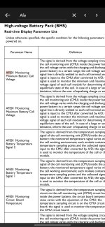

No need to guess, just use vdi and you can see what's data is available to service centers as well.
The MG4 BMS groups cells into 9 AFE. For each AFE you get min and max cell voltage plus some temperature stats.
If you get VDS you can even live log the data while driving and export it for later analysis if I remember right

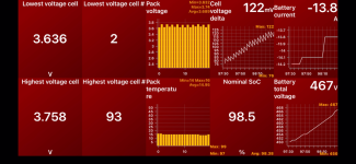

Similar to MG4. I just repeated this balancing check and video'd it. Not a lot to see just whats below.
Gets to 99%, HV cell trips simultaneously at 3.66V and charging goes to "trickle mode" on FICM and instantly reports 100%. Here I think (?) HV cell gets top trimmed by resistive balancing until trickle charge notation switches off on FICM at delta of ~150mV. Balancing top cell slows considerably until I provide a load, which could be just surface charge slowly blowing off.
Dollars to donuts there is no supportive charging to LV cell(s) to do a decent balance. Or trickle charging whilst burning off HV cell does very little. Not criticising just curious what is happening just not what my other LIFePO4 banks do.
Which is, balancing starts at 3.4V , with hi ---> low, while still maintaining decent charge rate so average bank voltage gets higher before "trickle charge" & resistive burn off. No point in starting it before 3.4V.
Essentially it means 100% SOC is governed by highest voltage cell and without active balancing results in well, not full capacity; the cheap way of doing it.

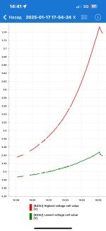

I charge our MG4 SE SR with a granny charger. The mains supply to the charger is switched on with a Shelly relay and this also monitors the mains power. And I can plot this with Home Assistant automation.
Not sure if this helps but I've just finished a balancing charge and this is what the mains power looks like:
Interesting
That looks exactly like in case of BYD Atto 3 with passive balancing !!!

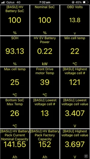

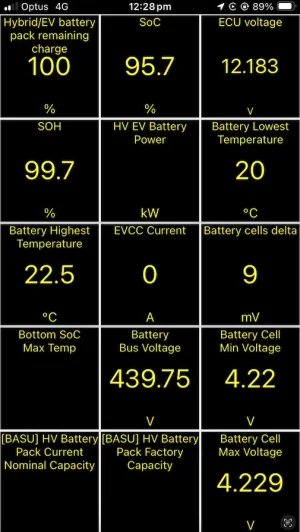

Since 2023 I had BYD Atto3 Extended Range and now have MG4 Essence 64 (NMC)
Both same age (2023 build), same 25,000km driven, much the same amount of minimal DC fast charging.
BYD SOH = 93%
MG4 SOH = 99.7 %
I can never get my BYD min cell voltage to be 3.6V - it is always 3.4V when reaching 100% and as Romeo says, this is when BYD stops charging completely.
With the MG4 the delta is <10 mV !
Today's balancing took 4 hours ! The car display actually says "battery balancing"
I can hear the relays clicking between HV battery modules.
I think SAIC/CATL have managed battery cell balancing better than BYD ?
I guess if I can balance my cells better in BYD then the SOH might increase higher than 93% ?
For my MG4 Car Scanner below, I haven't had time to optimise some sensors - some things are from my BYD layout
MG4:
BYD:
