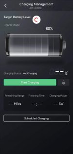

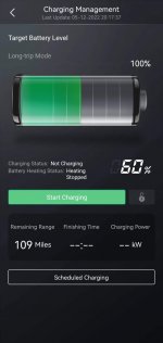

Just notice in the battery management screew on ismart, one shows health mode and one shows long-trip mode.
Any idea how to switch in between?

Do you have a LR? It only works on those by touching the arrows below the battery.
Tap on the battery to move the slider. 50% -80% are health mode and 80%+ is long trip mode

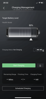

Previously my app showed the target arrow (even though I have an SE SR) but now it doesn't and the only mode is Long-trip (100% target).

That's what i remembered, I believe I have see that and I reduced it to 80%.

I keep getting the same. If you unbind the app from the car and rebind the option comes back but it's flakey as hell...
SE (LiFe, The basic entry model) I have I the past successful set and it worked, recently it has failed to work
You're not meant to have the option to stop the charge at 80% (or indeed anywhere below 100%) in the SR (LFP battery) cars. At one point it existed (before I got my car) because MG gave the same software in the app to everyone. However they removed that facility for the LFP-battery cars, because it's best for the LFP battery to let it charge to 100% and balance. There is no benefit to stopping it at 80%, and if you do that it won't balance, and that's not good for it.
You won't do your LFP battery any significant harm by letting it go to 100% every time. It has a very different chemistry from the NMC batteries, to which the advice to stay between 20% and 80% applies. Don't worry about it. Enjoy the simplicity and the extra range.
