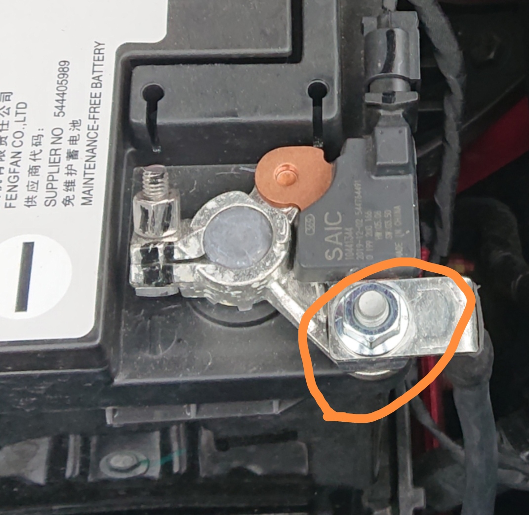

I need to get a better look at it may be someone can post a pic of the factory connector?
Looking at that picture I would say it's easier to just bolt on the positive side no cutting need
It looks similar to the Fiat idea, but it does not have the quick release button.
It favours the old 10mm bolt clamp.
I am not sure how you would be able to adapt the after market one really ????.
It has that "Black Box" of tricks behind, where the main negative terminal bolts to the battery.
Has anyone noticed that the battery Isolator has a battery type terminal on it so theoretically you can fit to battery then fit you original one to the isolator
I think you may struggle to get the "wings" past the battery @N2STY ?.
Sorry was thinking this bit with wing nut

Pure guess, but that larger nut looks like 13mm spanner size to me ??.
Would need a bigger wing nut, but it would need a metric thread also ????.
A friend with a lathe is what you need.
Short length of HEX bar, about twice the length of the original nut ( to clear the top of the battery case ) then machine a thread on the inside.
Weld a short section across the top to form a "T" Bar nut.
Your done.
No spanner needed !

I have M4 to M12 not a problem
its probably a M8 then👍
