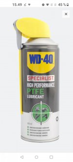

Hi.
As many things in life also door handles also needs a little lubrication once in while, we have done it also and now they work fine. Use a spray bottle with a long nozzle, silicone or PTFE variants all work fine.
This one is always good to have, they also make the Silicone and other variants ( classic blue) but this lubricates better.

I was always under the impression that WD40 is more of a cleaner than a lubricator. It is slippery when first applied and is useful for 'loosing stuff' but is probably not the best thing to use for this particular application.
I agree WD40 is not best lubricant but works well as a water dispersant.
Hopefully preventing ice forming.
If you still feel the need - a follow up with lubricant, as Kithmo suggests, might be the best solution.

WD40 original, dries out, and loses its lubricant quality, use a silicon or PTFE as above it retains the lubricant qualities longer than the plain WD40. WD40 is fine for a quick fix though

That's because it's not intended to be a lubricant, It's a water dispersant (hence the name).
