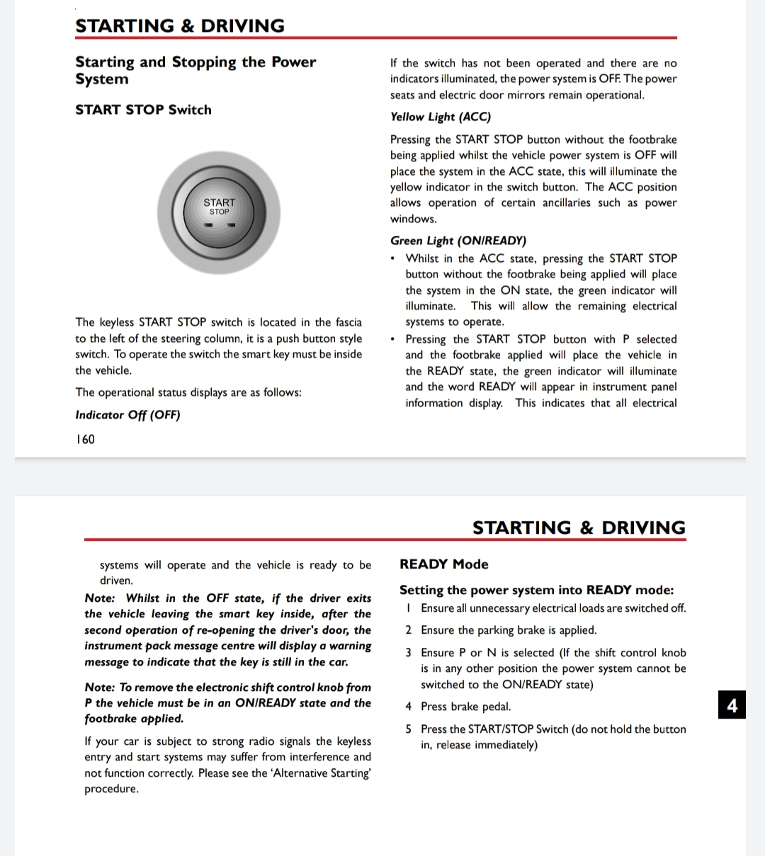

Apparently, the kit uses the lighter socket & 'needs the key in the vehicle & the ignition set to accessories to make it work'. What is 'set to accessories'? I assume this might be also the same as (say) waiting in the car listening to the radio, being able to use the windows and or aircon? Haven't seen this one before but perhaps should scour the manual further.
It's so you don't drain the battery pumping up the tyre
That's just ready mode page 258 in manual
Mine switches off after 10 minutes in accessory mode to preserve the 12v.
I would put it in ready mode so it doesn't switch off part way through pumping the tyre up.
Accessory mode would be pushing the dash button without your foot on the brake, wakes the car up without starting it, same as turning the key one click in an ICE
