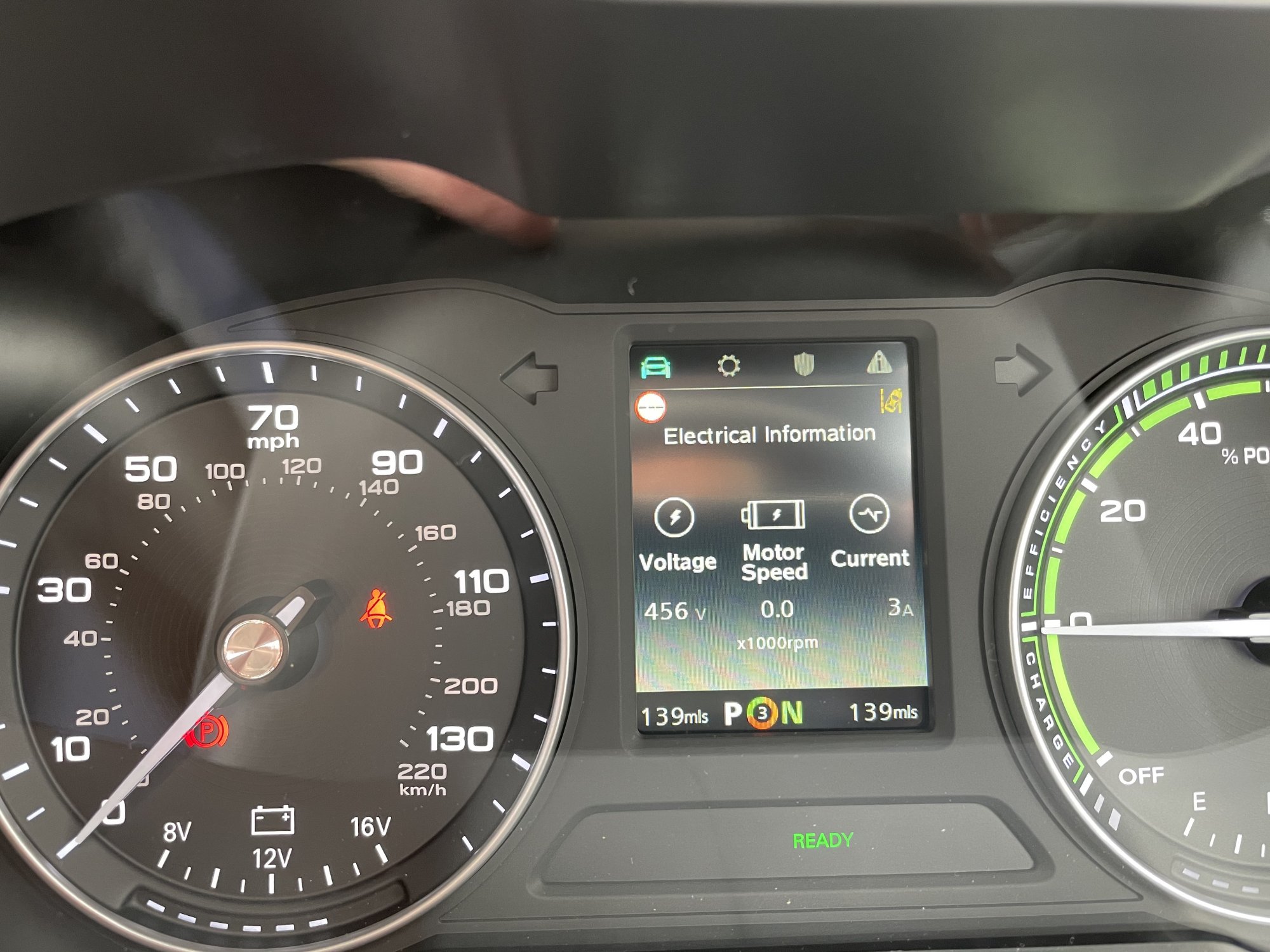

My zs ev is only just over a week old, and I gave it a full charge on 7kw home charge till the light went out. It only shows 456v with a range of 139 miles.
The range is reduced as you have something running in the car. The display shows 3A (HVAC?). Turn everything off to get the max range (guess) in each driving mode (Normal, Eco, Sport).
As for the BMS.....who knows? Is the car brand new?
got the car on 1st march brand new. The only thing running when i took pic was dash cam, would that reduce it that much
TBH....I'm no expert. But 3A seems rather a lot for a dash cam.

Turn the car on, by pressing the start button WITHOUT the brake pedal pressed. The HV battery will not be on then and will be under no load.
If you want a range figure to compare to others, you must also reset the Accumulated Trip, as that will reset the GOM calculation.

It can't be the dash cam as such, as it's running from the 12v battery system.
The HV battery could be charging the 12v battery of course.
