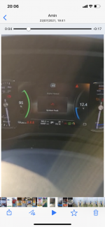

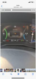

My car went in twice to MG. they update software say problem solved but after I use rapid charge same happens again.
It is ok with slow charge.
MG haven’t given me any report on both times i when taken it in to be checked.
what could be problem?

Hi are you sure you are starting the car in the correct Way I have seen this kind of reading on the dash when I have pressed the start button but not had my foot on the foot brake so turn off again wait a few seconds press the brake now switch on again hope this might help

This seems to happen when I am using the rapid charge. It charges upto 95% then shuts off and the sign comes up.
Yep, really need more info on what your problem actually is. I get that hv battery cut off all the time when as said above I press the start button without my foot on the break.
Ah, this is a common issue. I've had it once when the charge got to 95%. Not sure if it's because your 12v battery gets low or because the main batt overheats. Wait ten minutes and the car starts ok makes me think it might be the 12v battery going low and the main batt charging it back up.

There's almost certainly an issue with the rapid charging software in the car. Unsurprising when you realise how buggy the AC charging is. It might be as simple as the 12v battery getting depleted but I suspect it's a bigger issue.
We need to compile some information to help us avoid recreating the same circumstances. I keep asking the same questions but don't think I've had answers:
  1. Which charger was it
  2. Was the car in 'ready' or accessories mode?

You have to insist for a report of the work carried out. You can still ask dealer to provide reports as they are digitally stored in MG database.
The battery has built in protection which kicks in under certain circumstances. The protection seems to isolate tthe HV battery for some time(suspected to be approx 10 mins).
As others have indicated switching off for approx 10 mins, locking and walking away outside the range of keyless system seems to do the trick for some members.
Suspect scenarios,
1. Long motorway drive on a hot day + Rapid charge cause very hot battery
2. A really long rapid charge session on a hot day
3. Car does not like the rapid charger. There can be misunderstandings between rapid charger and the car sometimes leading to this behaviour.
If urgent, people are able to recover quickly from the situation by disconnecting & reconnecting 12 V battery, effectively resetting the car and clears the error code stored in the car.
Last resort which you probably already tried is call AA and dispatch to MG dealer.
Personally I think it would be better if the error message were this " HV Battery shutoff, please try after 10 mins".
Since you are close to holiday and probably will not have another diagnosis, can I suggest, avoid running down the battery to low and then charging it back to high percentage on rapid. Instead, plan more breaks in your journey with shorter top up sessions on rapids.
Carry a 10mm spanner in car to reset as described before if nothing else works.
When it happened to me it was close to the scenario Leo describes. Very hot day and had the ac on so that each time I powered up to check charge it drained the 12v battery a bit more.
