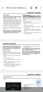

The official guide to home charging from the MG4 user manual...
Why are words in the Note at the beginning of the text not the same as that at the end? They seem to offer conflicting advice - 'on' and 'off'.
Actually I think these instructions are for the 13amp plug, not a 7kW home charger. Shut off the power means at the domestic plug socket.
I have 2 versions of the manual. Attached are 2 pages covering AC charging. The first Note on the second page relates to the instructions on the first page with the second Note covering 'Residential Charging'. I have always used the app to find the state of charge using my granny charger but will see if switching off the 13amp supply displays the charge on the info screen.
