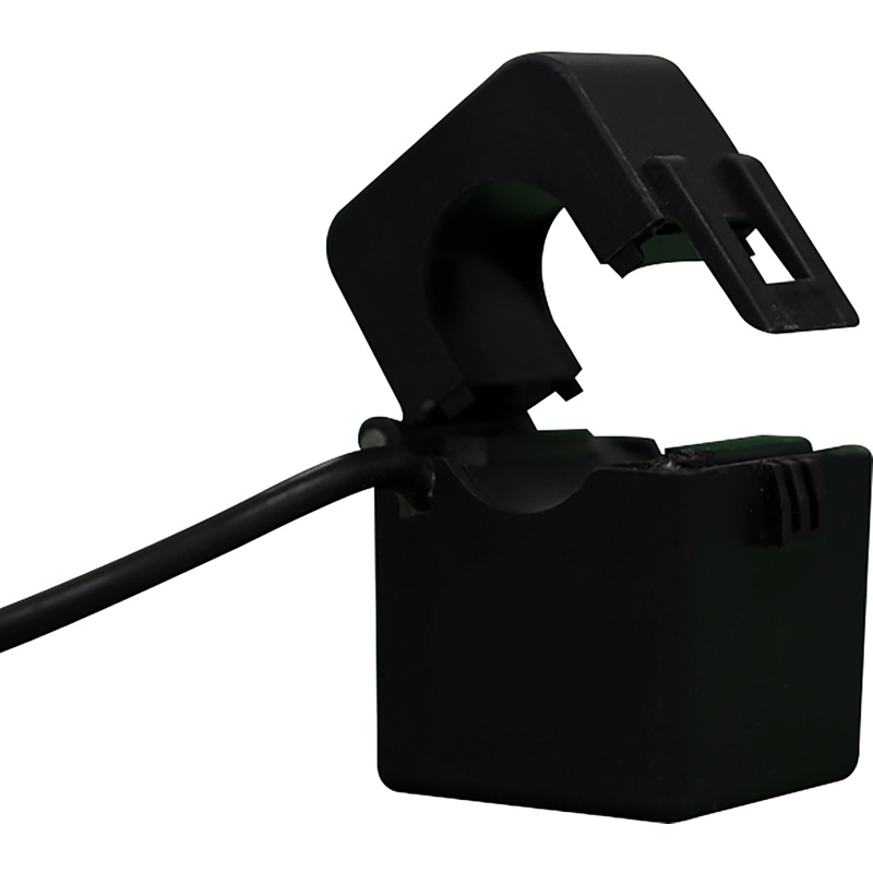

Don't you have to cut the wire or take the plug off to attach the ring?
Yes. The heavy mains cable had to be cut anyway, to pass into, and out of, the two cable entries. It was then stripped back. The live conductor was put through the current transformer and joined with a suitable connector, whicl also allowed me to connect the live feed to the meter. The neutral and earth leads were cut a bit shorter and rejoined. The neutral feed to the meter was also connected to the neutral supply line.

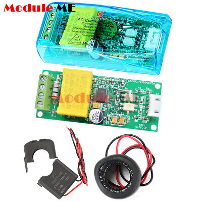

Someone has promised to help me build something similar to use with my Raspberry Pi (though so far it sounds like it could be beyond my capabilities) and it uses a clamp rather than a ring, so easily portable between cables. Like this, which coincidentally appears to be for an EV project.
Would something like this make life a lot simpler? AC power measurement done by a dedicated specialist chip, leaving your Raspberry to just worry about number crunching and Comms.
Yes, I'd skipped the detail, that's very similar (same as, maybe) to what it is based on, with the addition of a WiFi card to relay data back to the HA Pi for display and recording. Data will go into a csv on my NAS I think, for crunching elsewhere (similar to how I operate with my half hourly Octopus data). When I can be bothered :)
