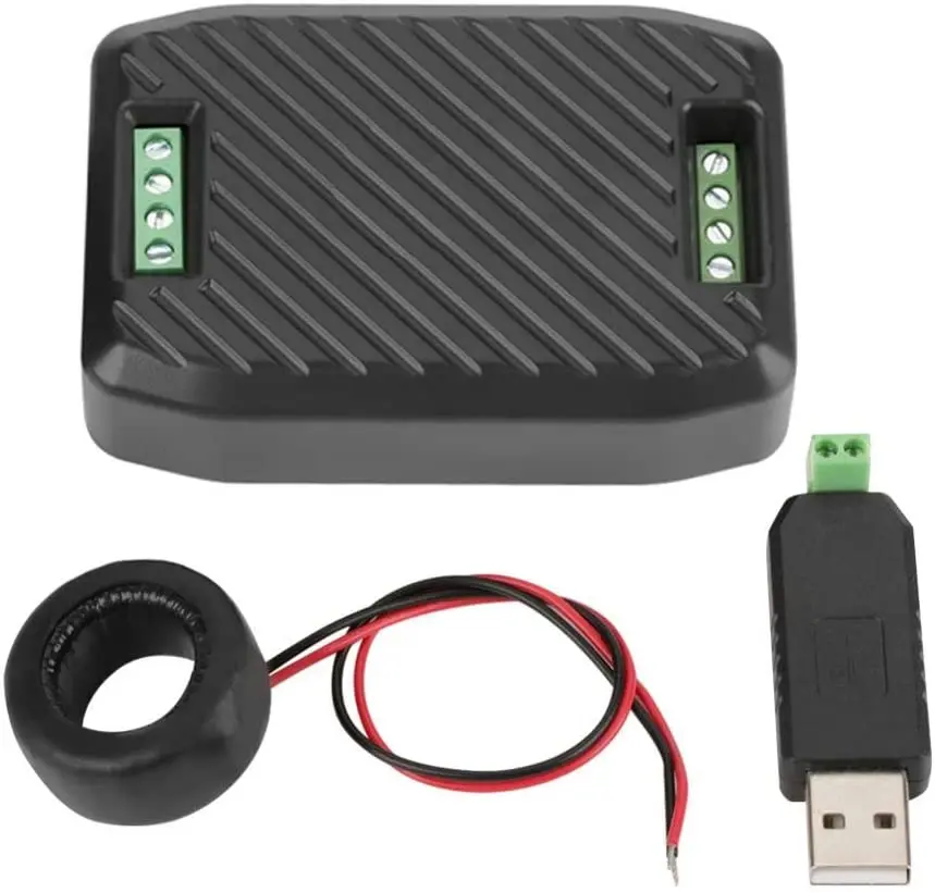

Like this, which coincidentally appears to be for an EV project.
ProjectEV is the name that Growatt EVSE are branded as by the UK importer. Good luck with getting any accurate calibration with that size of clamp - it's designed for meter tails not small wires.
I presume that you have used suitably rated joints such as Wago connectors?
As with any extension lead you lose the benefit of the temperature sensing plug at the end of the pEVSE when plugging into an "unknown" socket so you'll need to monitor it carefully.
Yup. Connectors are suitably rated. The plug and line socket have both been in use for some time (with very careful monitoring, especially at the first few uses) with nothing untoward. The wiring to both was undisturbed, as I just cut the able and inserted the monitor box.

That kind of thing, plus the inevitable need to guesstimate, is one driving reason for building my power meter.
One of these fine days, especially if other family end up with EV charge points, I might treat myself to another one of those little modules and build a monitored Type 2 lead. (Naturally being careful to maintain cable safety functions and physical integrity)
