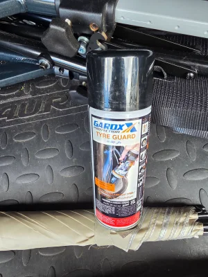

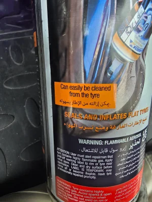

Why dont you get GARDX TYRE REPAIR. This is washable after use so 8f not too much damage to tyre it can be reused

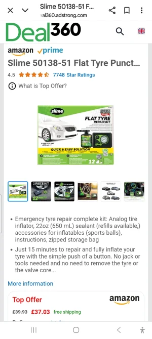

Why the need for spare wheel. This item is water soluble and is connected to a charger. Once repaired the sealant can be washed away and tyre reused again
