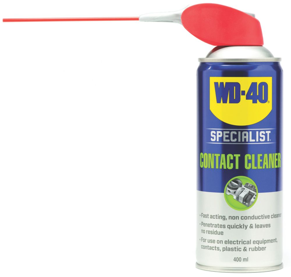

I've been using one of these without any issue, and it doesn't get warm.
But I always spray the pins of the mains plugs (extension and granny) with this
It tends to be dirty contacts causing resistance that get warm!
