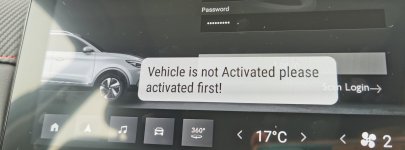

Having trouble pairing MG zs ev trophy connect with the iSmart app!
The car doesn't even display a qr code to scan and the when trying to login manually I get a message saying the vehicle is not activated. Anyone having the same problem and know how to fix it?

I've been able to register the app on my phone, but I have no way of pairing it to the car because the QR code doesn't display and when I try login manually on the car screen I get a message saying the vehicle is not Activated

I've figured it out for anyone who has the same issue, you have to first activate the vehicle before you can connect to the app, this can be done in the settings menu of the car.

Yes the car in their video must have already been "activated" in settings so they could just connect to the app straight away using the QR code. If the car is not activated then the QR code won't show and the car won't connect.
