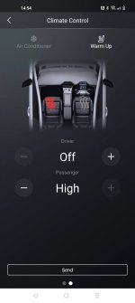

My wife asked me to preheat the driver's seat from the app yesterday (the cold weather has reached London) but it didn't come on, despite the app saying it was on. Interesting - time to investigate.
As I recall, the original bug with this function was that if you set the driver's seat to come on (using the app) then the passenger seat came on instead. However, if you ignored the words Driver/Passenger, the display on the app screen of the seat(s) warming up was correct. (I'm talking about the wiggly red lines on the image of the seat). So the app was half right.
This is no longer true: the app is completely wrong. No doubt SAIC tried to fix the original bug, but they blew it. They have made the words Driver/Passenger consistent with the heated seat image, but have applied it to the wrong seat. So when I set Passenger to heat up, the image on the app screen shows the left hand seat with the red warming lines (see image below) - great, you think. Wrong! it is actually heating the driver's (right hand) seat! Holy crap, you might say . . .
But before we get too excited by this, can we determine whether this new bug is universal, or does it only happen on this one-year-old Trophy? I have tried it both ways, and it is consistently wrong on my car.

Originally it showed as left hand drive but if you picked the right hand seat you got the right hand seat. When they switched to show right hand drive unfortunately they also switched the sides so now if you ask for the left hand seat you get the right hand side heating. They totally f##ked it up. I have reported it on play store and also e mailed MG UK customer support some time ago but as yet not been fixed.
The picture shows the steering wheel on the right, and the left seat being heated when passenger is selected, but in the car, it's definitely the right hand seat being heated up.
The app seems to know the right orientation of the car, but it seems to be sending the wrong API request to the car. At the API level (app talking to the car), it would probably be defined as left & right, not driver & passenger. The fact that the wrong seat is being activated suggests that the app is sending the wrong command, telling it to activate the left seat instead of the right seat.

What to do? If you want the driver's seat heated, turn on the passenger one. If you can't remember what the problem is, turn both seats on - that works!
