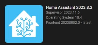

I'm not sure what docker means. I use this version of HA on a Raspberry Pi.
