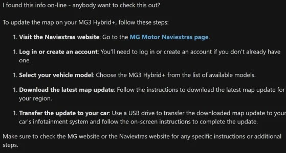

You put the fat32 usb in the car and create the initial fingerprint file and it writes a file called synctool. I tried to update the maps but Navitool box does not recognise the usb drive. The latest maps on Naviextras are feb 2024. I have spoken to MG customer services who say use Naviextras but there are only maps listed for old MG 3. My dealership says maps will be released later in the year and will not be using naviextras. Best to wait for confirmation.
follow instructions
