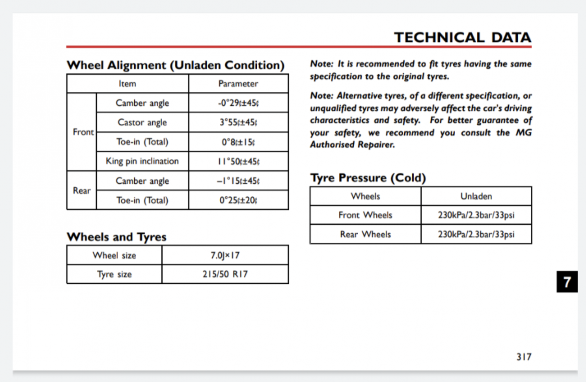

It will make a difference, but please also ensure you up the tyre pressure as that will help with your rolling tyre resistance, the manual recommended 42 psi cold for a fully loaded car.
42psi? The manual states 33psi when cold:
Yes - the manual is not great is it? If you look inside the drivers door shut the laden and unladen pressures are on a plate there - you’ll see Mark is correct.
Makes a big difference to mile per KWh, that’s the unladen or one driver PSI
