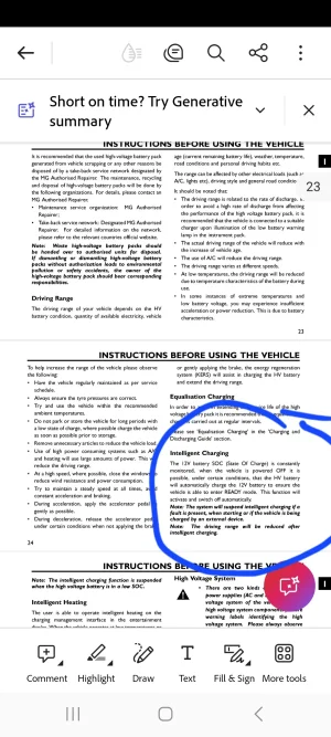

According to the manual I downloaded the S5 does monitor the 12vdc battery when powered off
Thanks, that's what I thought. Need to try it out and see how it behaves. Taken at face value you could run a camera 24/7 because the traction battery will keep it going for a very long time.
